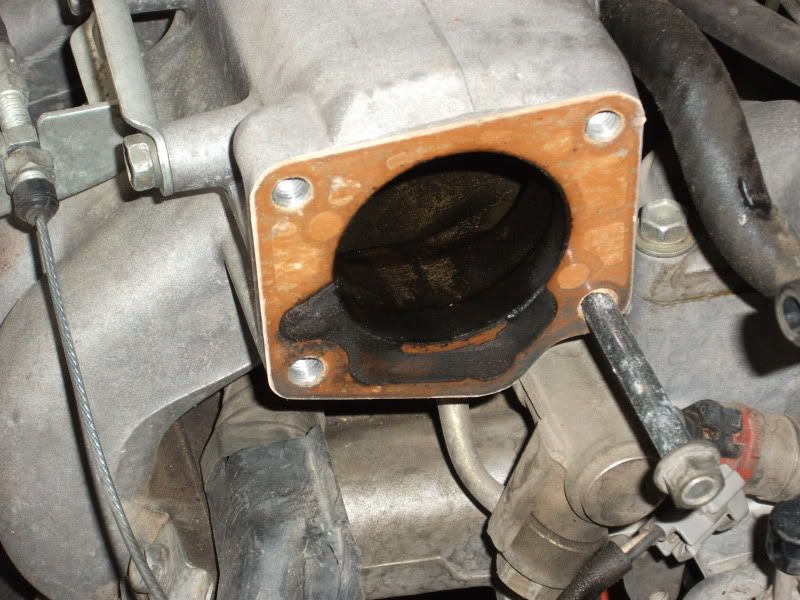

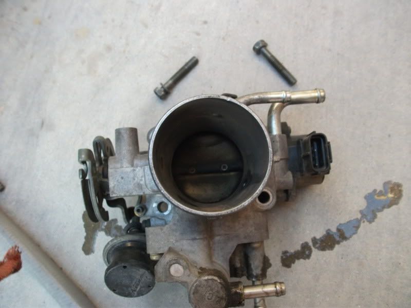

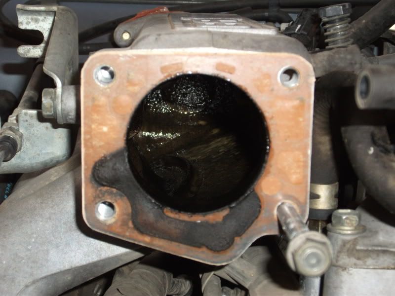

    well good news! before i started tearing it down it fired up and ran decently good..didn't let it run for too long cuz i lost all my coolant, just wanted to see if it would start to give me a better idea if its the HG or not
    Once i get a compression tester i'll know for sure, but no water in the oil either, well at least nothing on the dipstick..
    but....as there is defintley something going on at the throttle body. I noticed the two rubber hoses coming off of it were really wet, wet to the point it was leaking onto the TB..
    Took the TB off and damn, lots of black crap in the intake manifold..how can i clean that out?!?!

    Seafoam/3 part cleaner for the running engine... otherwise the local auto store stocks carb/intake cleaner... since it looks like you've done most of the work to get the intake off may as well do the rest.
    also it looks like the pcv is working correctly ... just rings/seals getting old and letting pressure into the block and taking some oil with it.

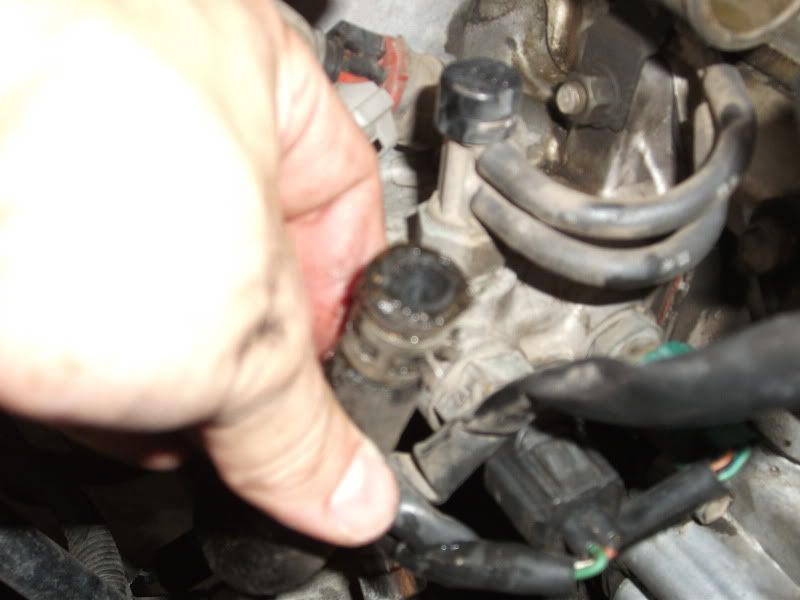

    Those two hoses are supposed to be wet... Water getting in behind the throttle plate is a different story... Looks like the cold air valve is shot!

    those two hoses control the cold idle and all.
    they shouldn't be pushing coolant into the actual throttle.
    and the black gunk,.. carb cleaner stuff....

    how can you tell about the cold air valve? It did have a crazy idle when it was cold, then it went away after it warmed up

    When the engine is cold the CAV lets bypassed air in from the front of the throttle plate. As the coolant heats up the wax/spring loaded valve, it starts to close the bypass air passage. Your idle will then start to settle as it warms up. Looks like water is getting in somewhere within this system by the looks of the pic that shows the back of the throttle plate...
    The picture of the plenum with what looks like milkshake (water/oil mix) has also got me thinking it may be pulling in that stuff from the PCV valve.
    Do a quick check of what the underside of your oil filler cap looks like. If there is a slight sign of water in the oil it will be milky under the cap!
    If that's the case throw out the CAV as the culprit and prepare for another HG change...
    *Did it run hot before you trun it off?
