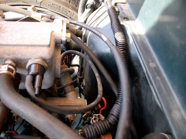

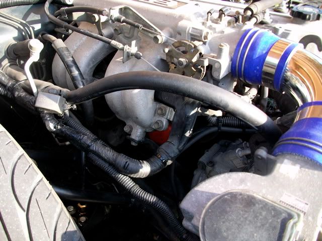

    Ok, finally have the time to post up some pics of my "cleaned" engine bay...
    This was before, just after my bagging experience.
    I did some research and exploring into the complexities of all of the EPA required crap sitting on top of my engine like pigeon poop. Turns out that only one of the valves there are at all useful. That would be the A/C throttle kick up, which is optional.

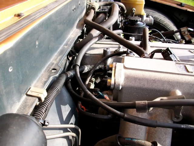

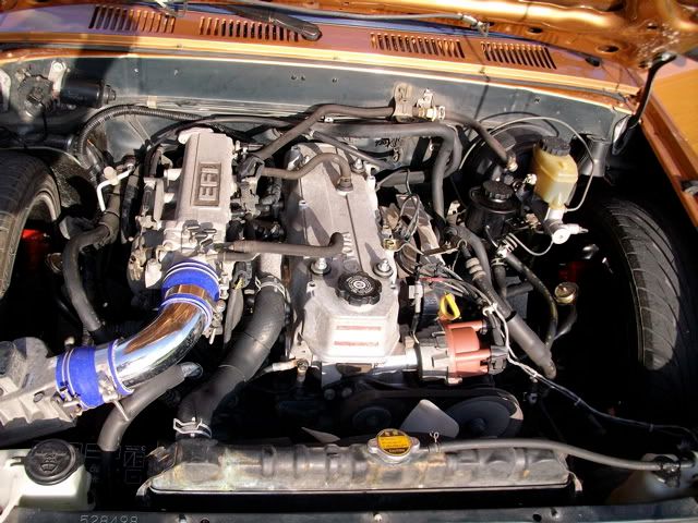

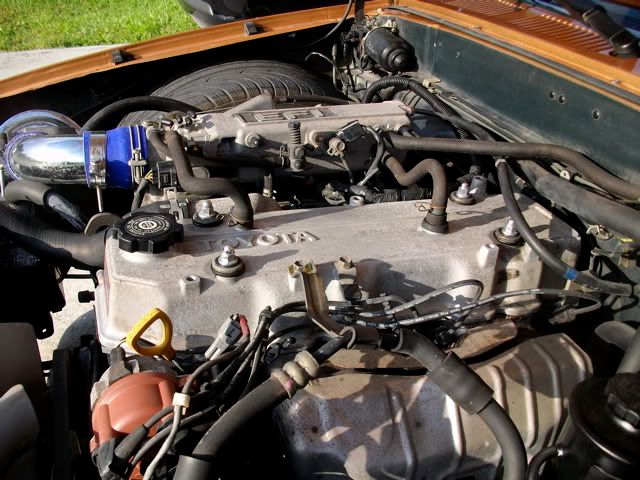

    This is after. With all of the EPA poop gone. Looks better, runs better (which leads me to believe that one of the valves may have been stuck).

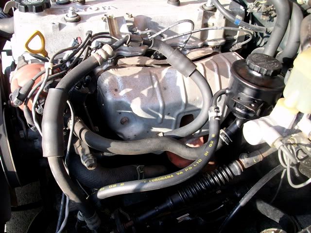

    Side views. Included is a shot of the new location for the power steering reservoir. The high pressure line will get replaced soon with a shorter line.

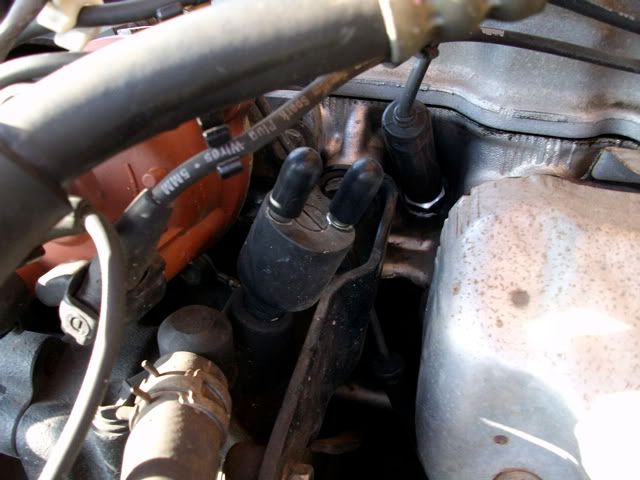

    Here you can see what has been done with all of the vacuum ports. About $6 worth of plugs takes care of everything.

    Pic of the power steering kick up valve (at least I think that is what it is for.)
    It was plumbed bypassing the A/C kick up regulator so I think it may keep the engine from stalling out if the load becomes too great at idle. I don't think I'll have that problem.
    New and temp vacuum line to the fuel pressure regulator. I will reroute this soon. This is needed to dump excess fuel pressure back to the tank at idle.
    And last but not least, removal of the EGR and AS. The Air Suction reed valve setup was below the intake and fed intake air into the exhaust manifold to aid in the breakdown of BLAH, BLAH, BLAH.......
    And we all know about the EGR. A set of block off plates from LC and WOW! It's really gone!

    I have since re installed the A/C kick up valve, will post a pic or two soon. I found that for whatever reason, the compressor clutch would not engage at idle. To get it to engage, I had to give it just a touch of throttle, then, let it idle again. Not worth it to me, so I tucked it below the harness on the inside of the intake manifold.

    I just started tracking stuff down and learning about what each component did. Put them all together, and started removing stuff I didn't need.
