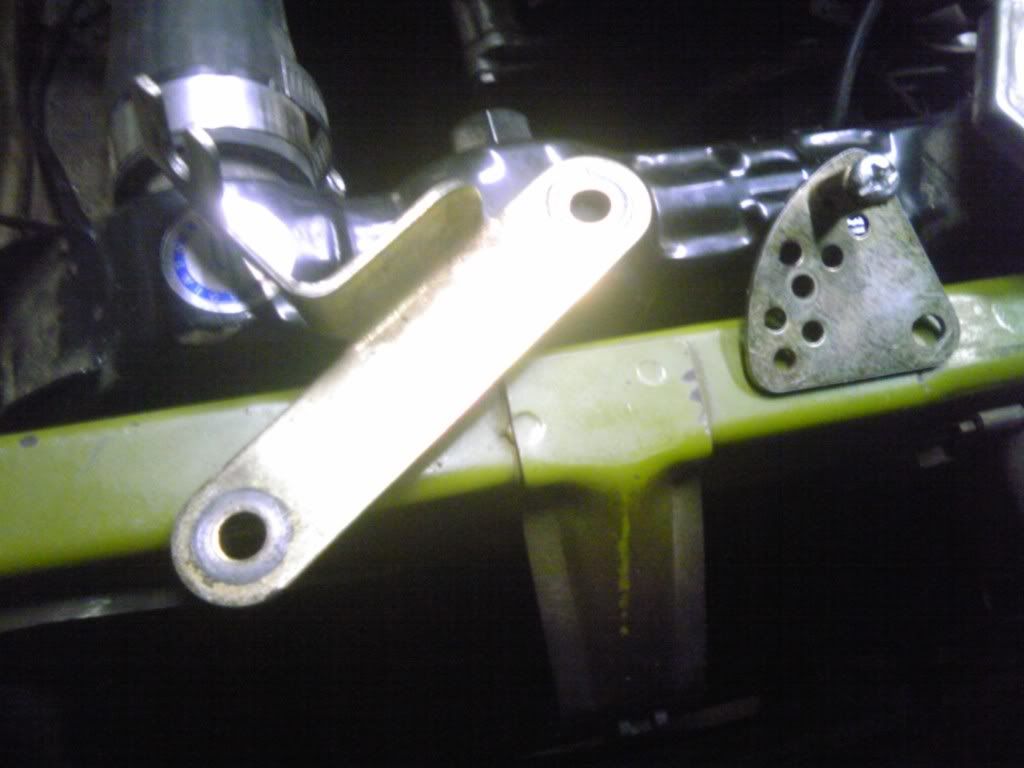

    So I just ditched my stock carb and all the emissions and vacuum crap for a used Weber, but I need help understanding the linkage, the Toyota Meet is the 27th and I still have a ton of **** to do!
    Heres the linkage section. One thing Im noticing is the stock linkage goes one direction and the carb goes the other.

    Do you have the linkage adapter kit? it has a C-shaped arm that the stock Toyota linkage hooks up with. You'll need that to make it work without using the cable to work the lever.
    Also what I've noticed is that you can't run that linkage arm with the heater hose in place on the intake, you'll have to put a pipe plug there. It runs right into it, ran into the same issue.
    It's the C-shaped piece you need for your setup:

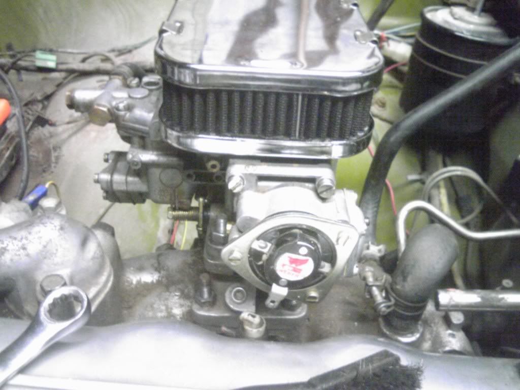

    I don't have that specific one but I do have the origonal c shaped bracket off the stocker. Also, what is the little connector for up front in my second pic

    The stock one won't work, it's too short. The stock carb's bigger.
    The only things you need to hook up to the Weber are:
    - Fuel line
    - throttle linkage
    - vacuum hose for distributor advance
    - breather hose for valve cover
    - key power wire for the choke (I think that's what you're asking about?)
    That should be it. Pretty simple carb.

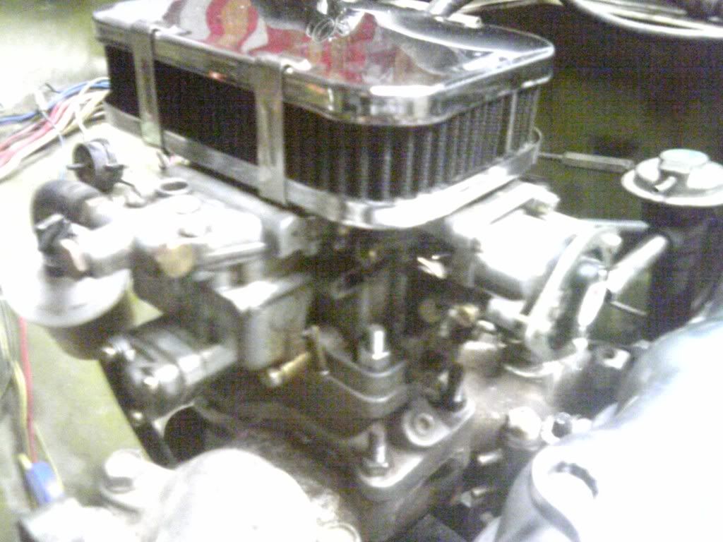

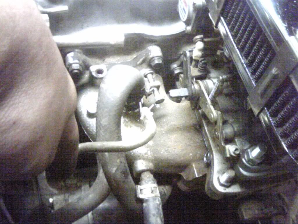

    Awesome. Last question. I've noticed the throtle direction of the weber is oposite that of the stock linkage.
    If your standing over the passenger fender the weber pulls and the stock pushes. Is there a way to switch this or am I boned?

    I think you have to switch the stock arm from one side to the other. Stock the link pushes down and rotates the arm. If you switch the side the link pushes down on it'll rotate the other direction. I never set mine up that way (I had other issues with my (fake) Weber... so it never worked right for me, but I figured that was the only way to do it. Someone correct me if I'm wrong... but you're right they rotate in opposite directions. I hope that makes sense, not sure how to describe it.
