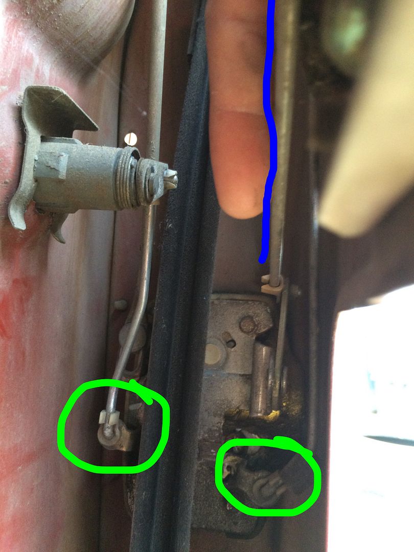

    The pieces circled in green are for the lock mechanism, they move together. Left side up/right side down is unlocked. The opposite is locked. The rod with the blue line and my finger is to the interior door handle, pull it towards the front and itl open if its unlocked duh.
    You probably already know this since youve been messing with it
