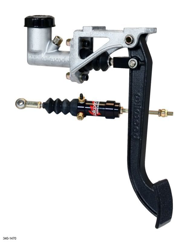

    This is what's in my truck.
    A remote reservoir will be the best bet for the fluid reservoir. 93/95 Honda Civic's have a plastic res that mounts on the firewall. Or Scott's Hot Rods has a full show res milled from billet aluminum.
    I just installed this in my truck. Its clean, the mounting hardware and hose are hidden.;)
    Another option would be a Willwood pedal assembly.
    It was all a pain in the ass, so be patient and prepared.:waytogo:

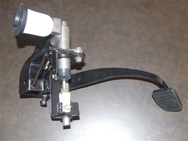

    This is my clutch master
    I turned it around! I welded a tab on the top of the pedal so it would work backwards! I can pop out my vent to fill the reservoir! I will post more detailed pics in a min

  12. Lotoy
    Lotoy Enthusiast
    Jun 7, 2013
    297
    knoxville tn
    92 std cab
    Clutch master
    Pics
  13. Lotoy
    Lotoy Enthusiast
    Jun 7, 2013
    297
    knoxville tn
    92 std cab
    Pics
    more pics

    I really like what you have done with yours. I have seen a few different ways it has been done and this looks the cleanest so far besides putting an all in one unit in.
