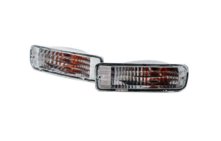

    i found bumper/valance on craigslist with the brackets for $80..is that a good price, what have you guys paid? i'm probably going to pick this up
    also does anyone know if 96-98 4runner turn signals will fit the 92-95? they look the same
    96-98
    92-95

    No the lights wont fit. Theyre different.
