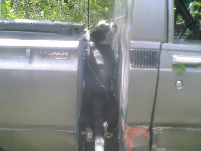

    if you really need the bed you can use a short bed on a long bed, doubles as handy dog storage

    that is a great dog
