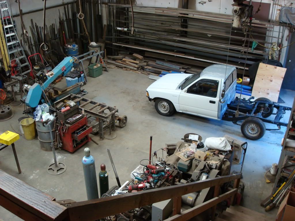

    First ever shop time for the slab!

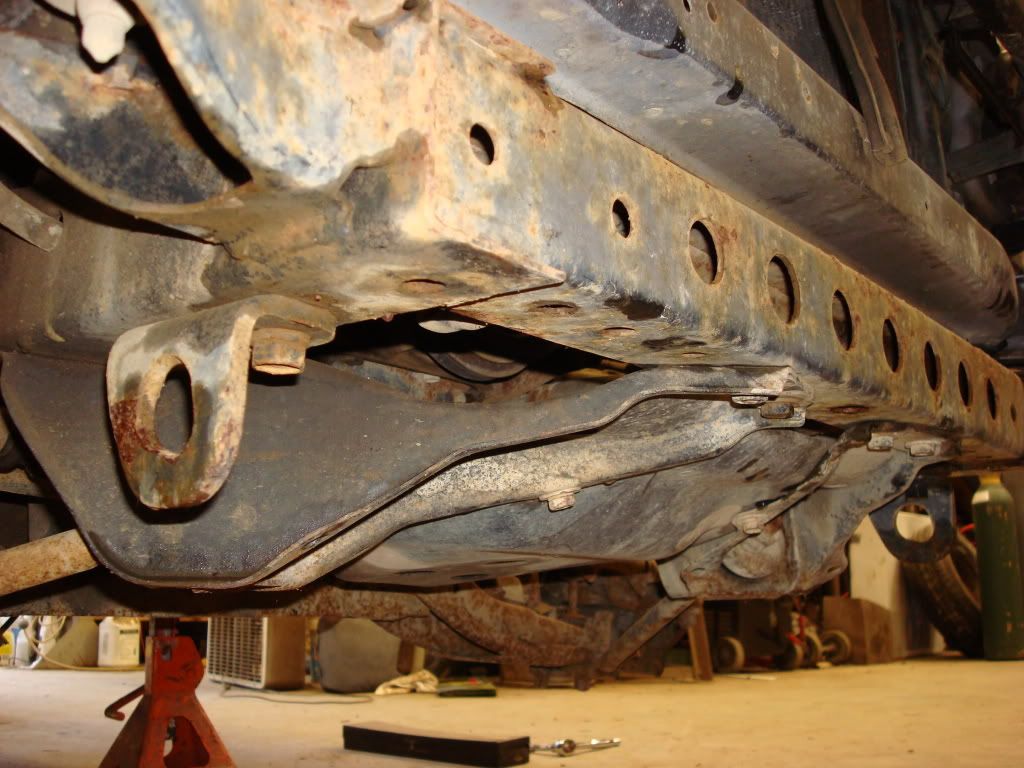

    Alright, so I got the truck in the shop which feels really good.
    I took off the doors, fenders, tires and hood for access. It is supported on jack stands 3" behind the second set of body mounts. I just ran into my first little ???.

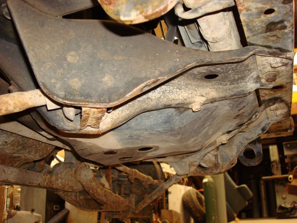

    There is a crossmember in the front of the frame that I am going to be cutting loose and lowering, but up until now I hadn't realized that I was going to have to modify these brackets.
    I am thinking cut them about in the middle of the bracket and put in a piece of 1/4" plate that sticks out on the bottom the amount needed for the drop (haven't got that measured yet). Does this sound like I am on the right track or is there some better way to modify the brackets? I am about to start marking out the cab cuts so I just have a little while to figure it out. Thanks a lot for the help!

    I was also wondering if there is any proble with taking out my torsion bars and just leaving them off when I have to drive it out of here (riding on the bump stops). I don't have to go far. I just have to be able to get it out of the way. I want to fab a new crossmember so I can lay frame and I don't want to deal with the torsion bar mounts in the stock one. Thanks again for the help!

    :eek:WOW! Well then I should be able to get it home no problem (1/4 mile). That's cool. Thanks for the info. So I am going to drop it 1 1/2" plus 3/4" for the pinch weld for a total of 2 1/4" drop. I think once I hammer the pinch weld over it should lay out pretty good. The floor pan cut is going to be pretty close to the door openings. I was picturing it farther in like on Seths write up, but it seems like the best place for e to cut to clear the body mounts is right inside the door.:shrug:

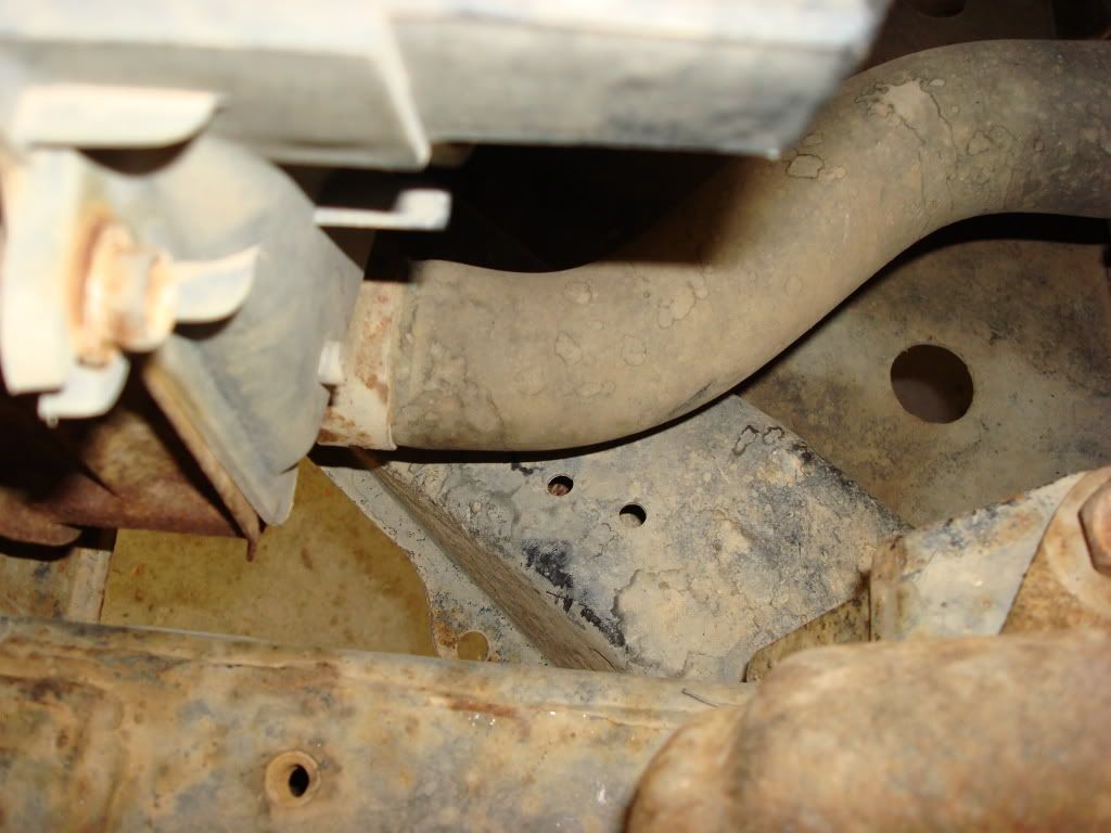

    I wonder what they did about the lower radiator hose in that write up? If I do the cross member like they did the radiator hose is going to run straight into it...:shrug: Any ideas? I could snap a pic if needed but at 2 1/4" down, the radiator lower outlet comes pretty much straight out at the crossmember and brackets.

    maybe a z-shaped piece of tubing to clear it?

    '79 4x4,'89 short-bed 2wd, '85 4Runner
