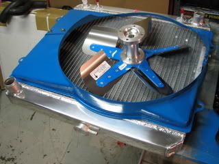

    Hey all, In my never ending quest to try different things, my wife says in wasting money, I,m off on another venture, I spent time getting the cooling system in my rig dialed in and working great, actually it runs on the cold side, but decided it needed a little shine so here goes, bought an all aluminum radiator, gotta build some new mounts to fit it in but thats no biggie, I already dumped the clutch fan setup in favor of the rigid fan and have no regrets, but hesitant on how well the aluminum rad will cool compared to the 3 row I had in it, guess we'll find out. Anybody running the aluminum, I know there are some of you, any comments?, pros?, cons?, good?, bad?.
    Nothing else it'll save a few pounds, and its shiny:D

    Thanks guys, I had read the aluminums will cool a lot better compared to the same size in brass/copper construction, we'll see how it works out. I have ran the Toyota brand red antifreeze for several years with no issues, other than price, mixed with distilled water, also have numerous ground cables under the hood and will also ground the rad once installed just to be cautious.
    Nuff, the flex fan isn't too bad noise wise, you can tell its there but not quite as bad as the locked clutch I had tried, at least on my setup, I just didn't like the idea of the locked clutch setup, considerably more dead weight spinning out there than the flex unit.
    OK, back to the garage, working on my rad mounts.

    Hey SSB, Yeah its one of the Ebay specials, actually I was a bit leery of it but after getting it was very pleased with the construction, my main reason for buying this particular one was the fact the side mounts are bolted on as opposed to welded like all the others I inquired about, that way I was able to remove them and build my own to fit my 75 truck.
    Another note was it was advertised as a 2 row core but in fact its actually a single row of about 1-1/4" tubing.
    I emailed the seller and they promptly said the early ones they sold were 2 row but had troubles because of the smaller tube size with blockage so they went to the larger single tube, they said it proved to cure the problems and also cooled better than the 2 row unit, which kinda agrees with a lot of what I read about the aluminum units, They also told me it had a lifetime warranty, except for collision, and if I had any problems to let them know and they would replace it. Sent name, addy, and phone numbers for contact which a lot of the ebay sellers would never do so I have no complaints about their service and figure what the Hey!! I'll give it a shot.

    The radiator like I got is made to fit the 84-88 trucks, so the stock plastic shroud for those years will bolt right on.
    In my case I,m using the stock 75 metal shroud, will work with the new rad mounts I,m building.
    My biggest problem was frontal clearance with the supercharger, AC, power steering, got lots of belts and pulleys down there to work around, if you notice the picture I posted I split the shroud in half, fabbed up a couple threaded tabs, now I can bolt the bottom half in place, mount the fan, spacers, all the junk needed, then drop the top half in and bolt them together, sure makes things a whole lot easier to work on that way.

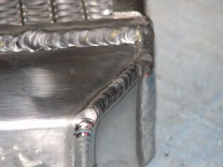

    are the ebay radiators mig or tig welded?
  15. Nook
    Nook Addict
    Feb 17, 2008
    631
    oregon
    tig? :confused: :confused: whichever, to me it looked good for aluminum welding :D
  16. trap
    trap Addict
    Aug 24, 2007
    506
    orange county ca
    92 pickup
    damn yours looks much nicer then mine. I think they experimented on mine to get the welder settings right.
    that looks like tig welding. I honestly couldn't tell with mine.
