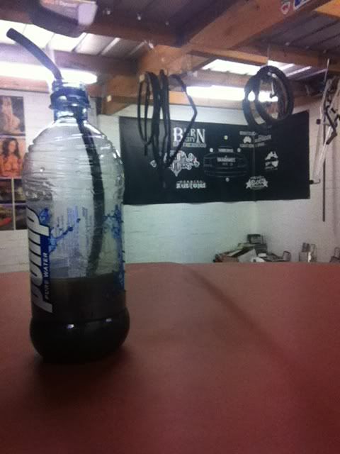

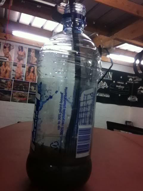

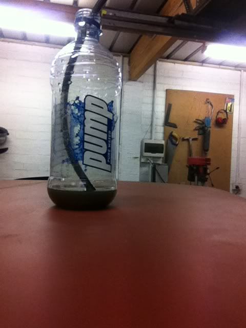

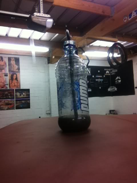

    alright we have lifted the inlet for 10th time checked everything resealed everything bolted back down.. changed from heater hose to proper vacuum hose. re bled each caliper, starting furtherest corner first 10 big hard pumps then bleed done each caliper 10 times... total 40 bleeds this is how much fluid came out
    rear pass
    then rear drivers
    then front drivers
    then front pass
    40 bleeds lucky to be 250ml of fluid... i think theres a fluid transfer problem.. any advice where to go from here?? proportioning valve?
