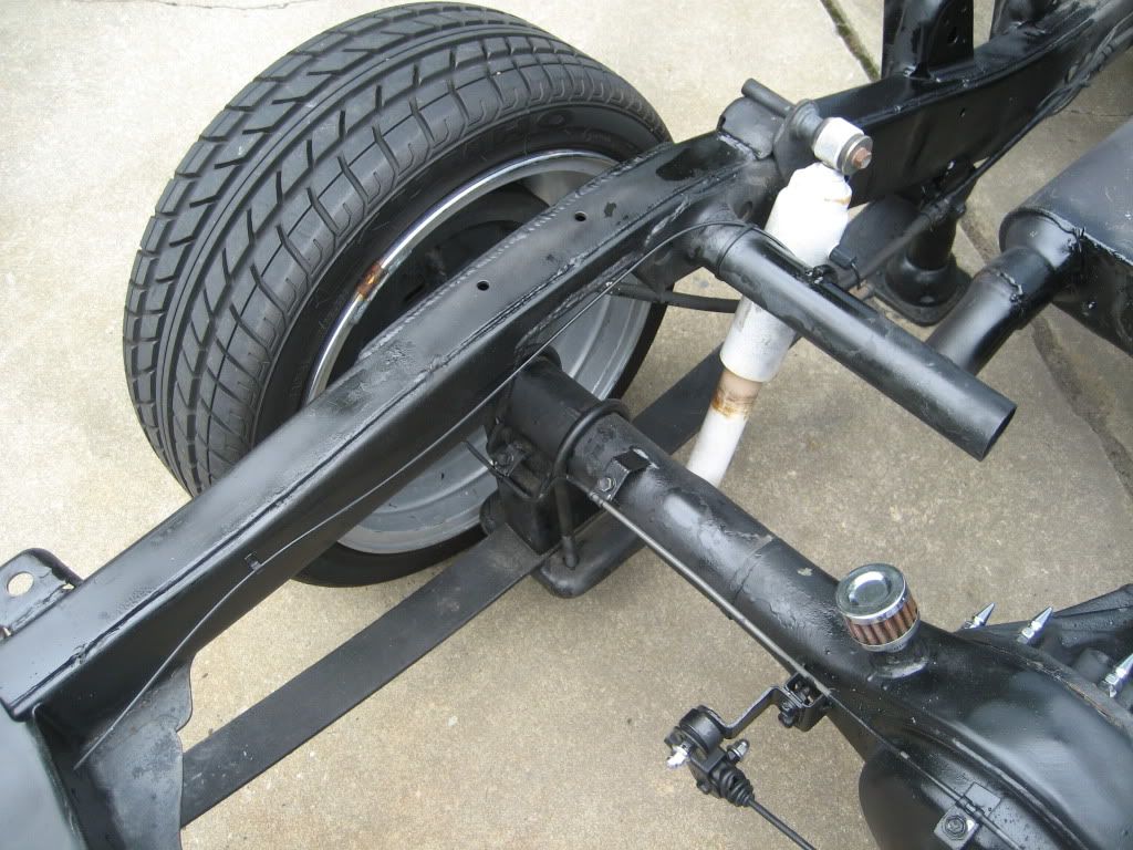

    I bought my Gabriel High Jacker air shocks off Ebay cause I wanted the shortest when compressed set I could find. I wanted my truck to bottom out in the c-notch so I took a few measurements & started looking. I emailed a seller on Ebay, told him what I was looking for & the part # he recommended was 39507. Now like I was saying earlier...I just wanted something to let my truck sit as low as possible, but get enough lift to get me around so this shock works great for me. They do however make a bigger shock that gets more lift. At one time you could buy these from Auto Zone or Advance Auto, but Im not 100% sure if they still carry them?!
    Not the best pic, but you can see what the shock does & what kind of lift I get with it. Oh & dont forget that youll need a air hose kit with these shocks too!!

    nice notch. and i dig the 3rd member spikes :D

    Thanks bro...just to let you guys know cause Im sure someone will ask. The nothch on my truck is a universal weld on from Alter Images or what you know
    now as CanDo Specialties. Its a 2.25 inch notch & most sites sell them as a bolt on, but I think its better/safer to weld it in. As for the spikes on the rear axle...those are called "pike nuts" & can be found at most motorcycle shops or on Ebay. They come in all lengths & thread patterns, but be warn they are "not" cheap!!

    What is under your spring hanger by the muffler? Looks like a stock jack but I'm not sure. I was just gonna retap some hot topic studs. I have a few good sized ones. And some black acorn 1/4"ish nuts from inside xboxs. LOL.

    Its a factory jack, but its just sitting there. I was using it to jack up the frame when I was taking some measurements, but let it down so people could get an idea on how my air shocks worked.

    I don't really know why i dont know, but why have an air breather on you rear dif? I should know but i dont for some reason.
