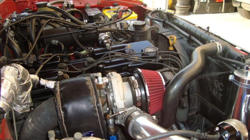

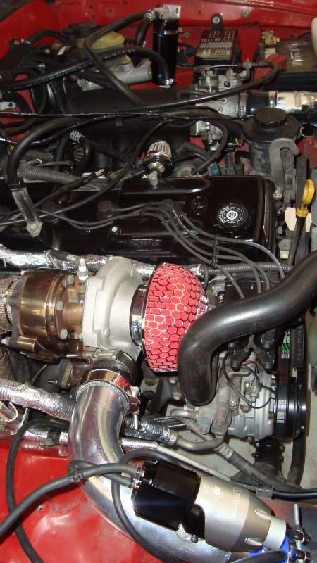

    Well I just wanted to share the build on my 95.5 Toyota Tacoma 2rz turbo build. My name is Brian and originally from Guam and now currently living in Houston, TX.
    Right now I am 7psi but will be turning up the boost to around 12-15psi as soon as I install my cometic hg and arp studs.
    I also have a detroit trutrac and stage 4 competition clutch coming in the mail very soon!
    So acquired the following parts for the install:
    Borgwarner t3/t4 turbo (Its a 57 trim compressor, with a stage 3 turbine wheel and a .55A/R turbine housing) (paradise racing)
    log style turbo manifold (customtacos)
    tial 38mm wastegate (craigslist)
    synapse bov
    cx racing intercooler / piping (ebay)
    oil lines and fittings (koracing)
    megasquirt install and tune (Gabe) (PM me if you want to inquire about getting a megasquirt he will be selling these soon)
    650cc injectors (ebay)
    walbro 255lph fuel pump (customtacos)
    innovative wideband (customtacos)
    Trd boost controller (customtacos)
    3" downpipe and exhaust (courtesy of Bob and welding by Gabe)
    magnaflow 3" in and out muffler (ebay)
    forward facing intake manifold
    The results:

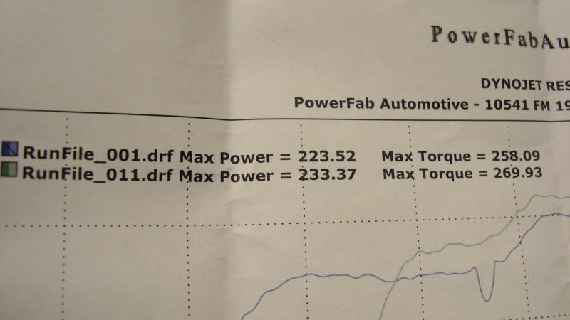

    what happened on the blue line?
  8. TRfknD
    TRfknD Veteran
    Nov 25, 2008
    425
    The Woodlands, TX via (Guahan)
    96 Taco / 05 Tundra
    The blue line was the base map I already had on the megasquirt. So it was my first run of the day on the dyno. The other line is the last run we had of the day. So I think that day we had a total of 11 dyno pulls.

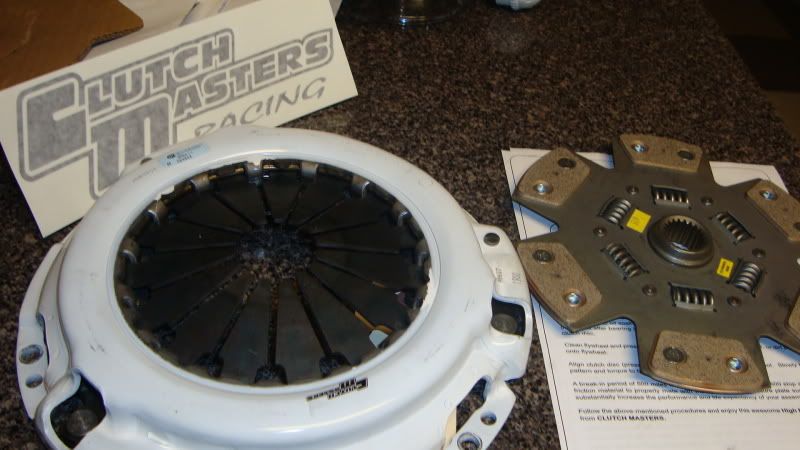

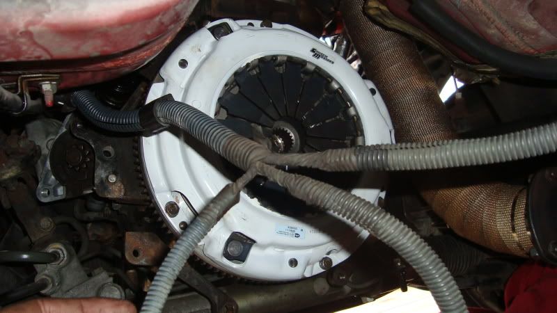

    Update
    Finally got my stage 4 (6 puck) clutch in yesterday. So BYE came over to the house and we installed it! No more slipping clutch! :cool:

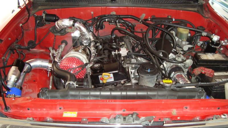

    It's been a while but I've installed the following:
    1. Clutchmasters Stage 4 6 puck sprung clutch
    2. Detroit truetrac w/ 3.73 gears
    3. Boost controller (hallman in cabin)
    4. Turbo blanket
    5. Weld draglites (15x5 front 15x8 rear)
