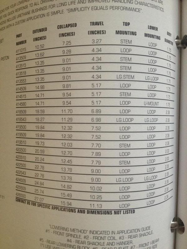

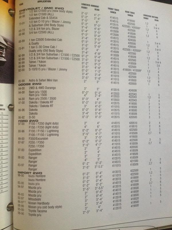

    Rockauto has shocks for your truck, they can also cross reference if your parts will fit other vehicles, procomp has toxic shocks in many lengths also, I have a catalog that specifies length, mount type and such, I wanted to use toxic but I couldn't resist the 37.00 bilsteins at stillen

    The last time I spoke to a procomp rep, he said most of their toxic shocks run 5/8 eyelet bushings, but I would call just to make sure.
    Toxic shocks
    Toxic shock application,
